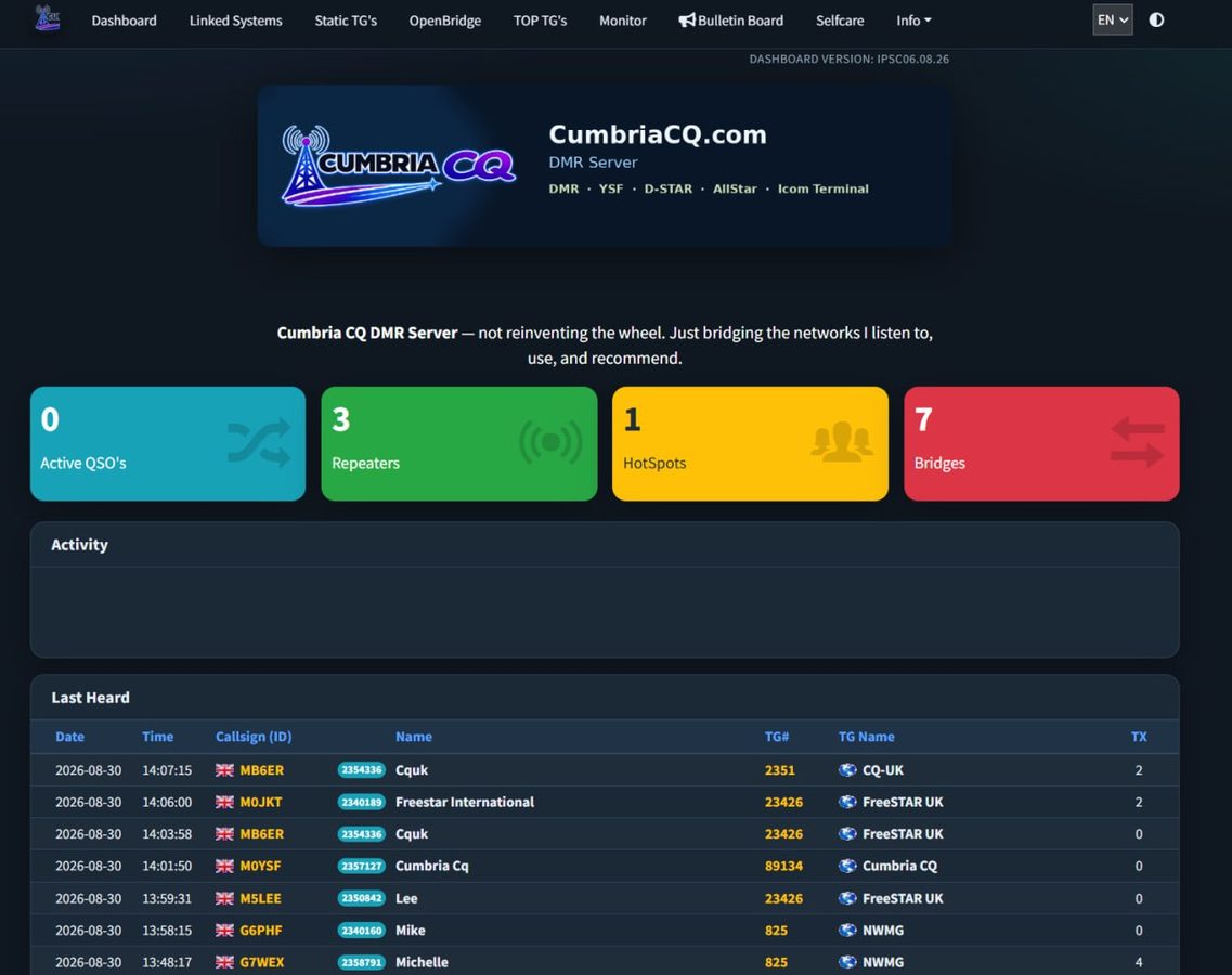

This is the own master. Dashboard and Selfcare: dmr.cumbriacq.com
Cumbria CQ DMR Server dashboard at dmr.cumbriacq.com

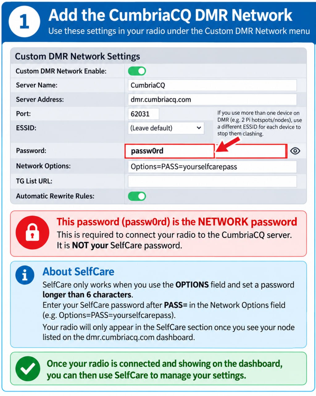

CumbriaCQ custom DMR network setup guide, including server settings, network password and SelfCare options
DMR network setup guide — tap the image to view full size.
If the simple button is there: Configuration → Add Custom DMR Network, then use the block below.
If it is not: Configuration → Advanced → Full Editor → DMR → DMRGateway. Scroll to the last [DMR Network …] server already in the file and paste this block underneath it. Do not overwrite Brandmeister or your other networks.
Set Id= to your 7-digit DMR ID only (no ESSID). Save and apply.

OpenSpot and Pi-Star: same host, port, password and your DMR ID. No ESSID.

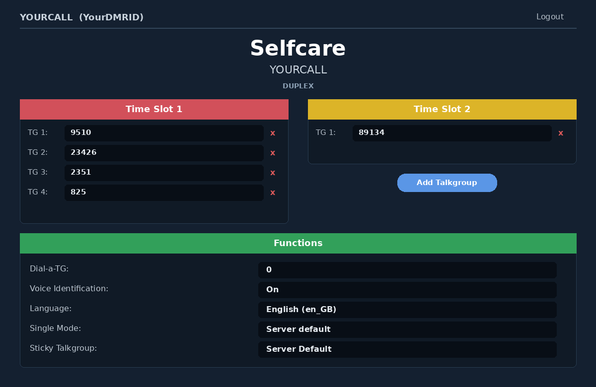

Selfcare
Selfcare sets which talkgroups sit on timeslot 1 and 2 for your hotspot.
Selfcare: Time Slot 1, Time Slot 2, Add Talkgroup, Functions
  1. Log the hotspot into the master first (it should show on the dashboard).
  2. In WPSD DMR Options set PASS= to a secret you choose (6+ characters). That is the Selfcare password — not passw0rd.
  3. Open dmr.cumbriacq.com → Selfcare.
  4. Sign in with your callsign or DMR ID.
  5. Under Time Slot 1 / Time Slot 2 highlight talkgroups then Add selected. Red X removes it.
A simple start: TS2 = 23534. Park extras on TS1. Apply, then wait for the hotspot to reconnect.

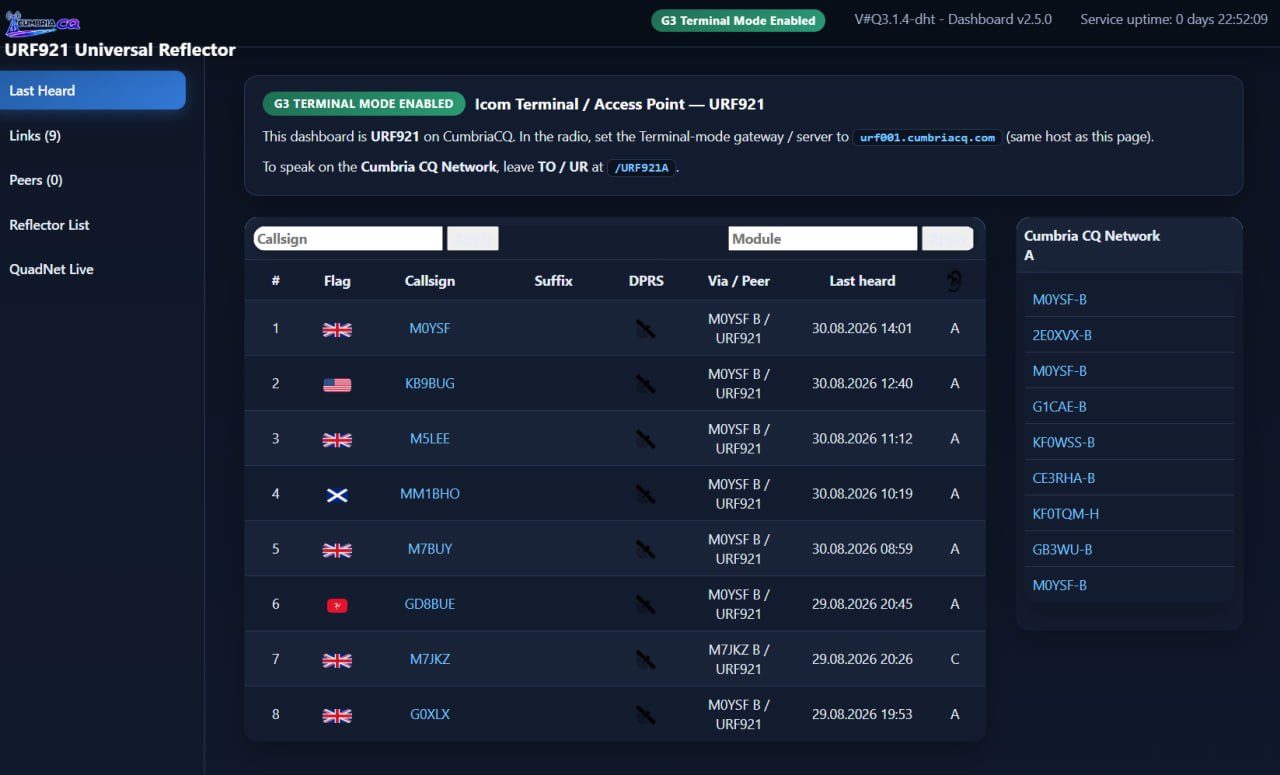

Option 2 — URF921 (talkgroup 6)
Same Cumbria CQ Network, via the URF921 reflector instead of the DMR master. Module A. On DMR, talk TG 6.
Dashboard: https://urf001.cumbriacq.com/urf/
URF921 Universal Reflector dashboard — Cumbria CQ Network module A
Host:     urf001.cumbriacq.com
Mode:     XLX / URF 921
Module:   A   (Cumbria CQ Network)
DMR TG:   6
WPSD / Pi-Star: enable the XLX connection, reflector 921, startup module A. On the radio use Group Call 6.
