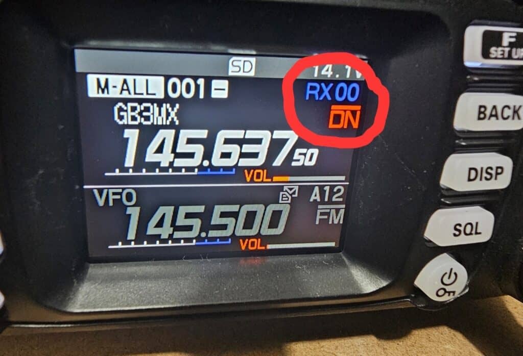

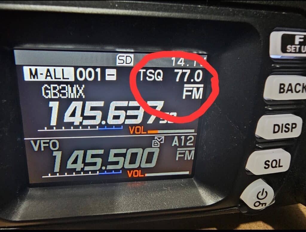

Setting up your radios
Yaesu Multimode Radios:
I suggest programming your radio with the Multimode option enabled. This is normally indicated by a RED line under the FM or DN Icon on the radio screen. the – symbol represents multimode is enabled on your radio

None Digital Radios (analogue FM radios)
I strongly recommend setting up your radio on the frequency with the decode and enclose settings enabled so that ONLY the tone of 77hz opens your radio up. If you don’t do this, you will receive the digital noise when the C4FM digital side is in use.
You can achieve this by enabling ctcss of 77hz on both the RX and TX of the radio.
